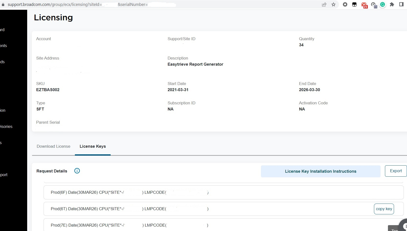

If it is required to use the IMS option and you are already licensed for it then the LMP key can be accessed using self-service from the Broadcom Support portal.
After login the My Dashboard page will show option My Entitlements.
Under My Entitlements search for your SiteID and you should be able to access your LMP keys.
Expand product name "Easytrieve Report Generator" and then for the first "Easytrieve Report Generator" line click on "Entitlement Details" e.g
For any Serial Number line use its Licenses hyperlink and it will load a page showing a "License Keys" tab e.g.
Some Serial Number lines Licenses hyperlinks may show a "License Keys" tab whereas others will not. For those that do they will all have all the same licenses listed regardless of the original product name chosen.
