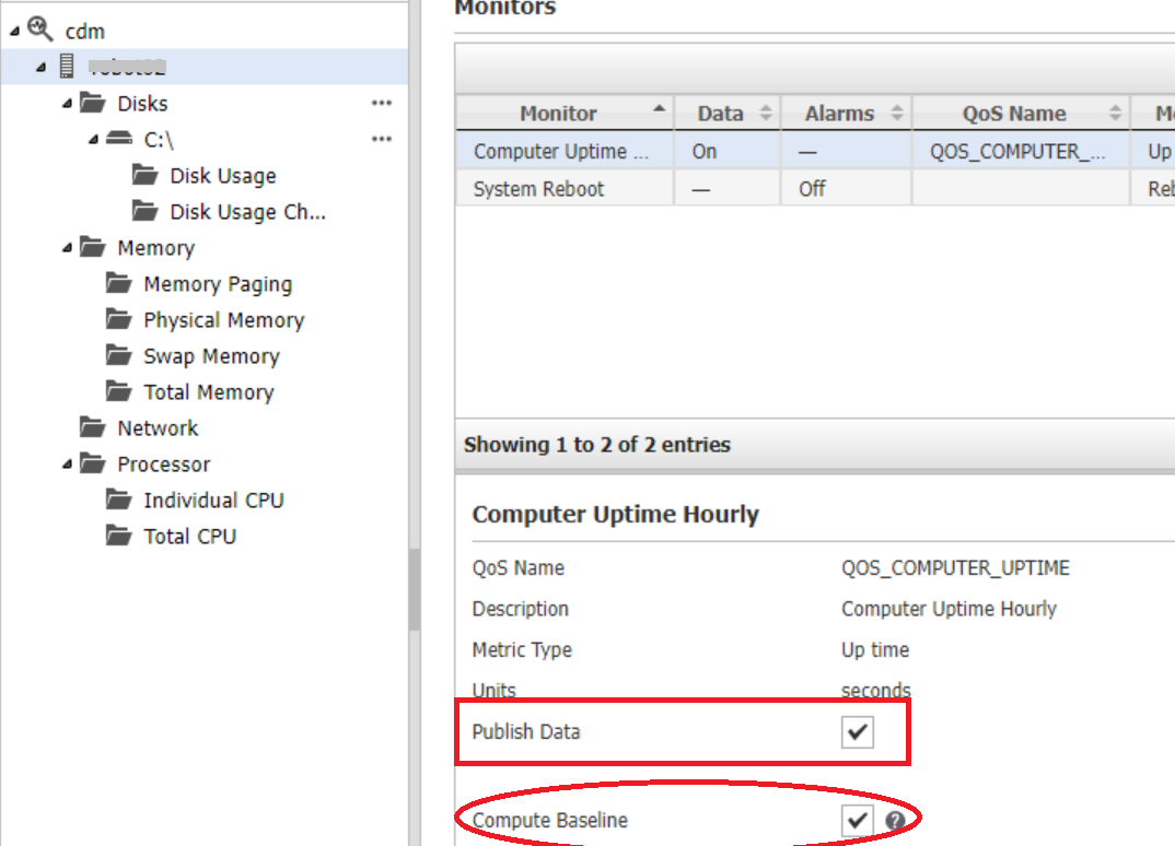

5. Login to Admin Console, and go to the robot you chose in 4. Select the Probes tab, and Configure any of them. Like for instance cdm probe or processes probe, or any other you prefer. For instance, I will select cdm probe for this example.
6. In the probe configuration, select a monitor, and on right panel check the "Compute Baseline" check box. Then click the Save button.
7. After a few minutes you should see the baseline_engine.QOS_MESSAGE queue show up in the hub Queues and Status Tab windows. The queues should be green and successfully processing messages.
