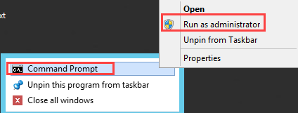

3. Launch a CMD prompt with "Run as Administrator"
