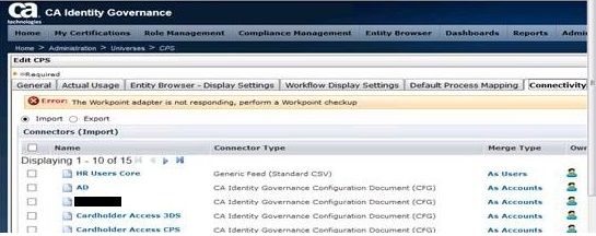

The import progress to create a universe stuck at "0% in progress". An error "The Workpoint adapter is not responding, perform a Workpoint Checkup" if the universe is opened.

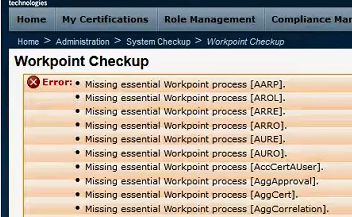

- Running Workpoint Checkup gives a lot of errors "missing essential workpoint process [xxxx]"
