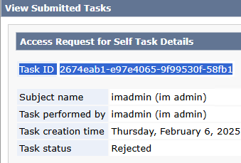

1. Determine the TasksessionID.   The tasks 'Task ID'
This can be gathered programmatically, for example with a TEWS6 call, or a direct database query, or manually found in the task View, see KB 16923 Search a submitted IM task by Task ID on View Submitted Tasks for details on how to configure VST to show Task ID values.
