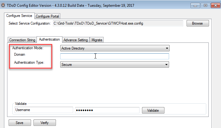

The remote engine uses secure mode user authentication, where as TDoD uses either secure or none. You should use secure mode to make it work in remote engine. The GTWCFHOST.exe.config file stores that information like this:
<ADSetting Domain="example.com" AuthType="Secure">
</ADSetting>

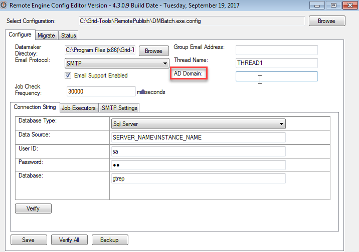

Make sure that the domain name you have in the TDoD configuration editor matches what is being presented in the log files. In the Remote Engine Config Editor, change the AD domain from example.com to your customer domain.
C:\Grid-Tools\TDoD\TDoD_ConfigEditor\TDoDConfigEditor.exe
C:\Grid-Tools\RemotePublish\RemotePublish_ConfigEditor\RemotePublishConfiguration.exe
