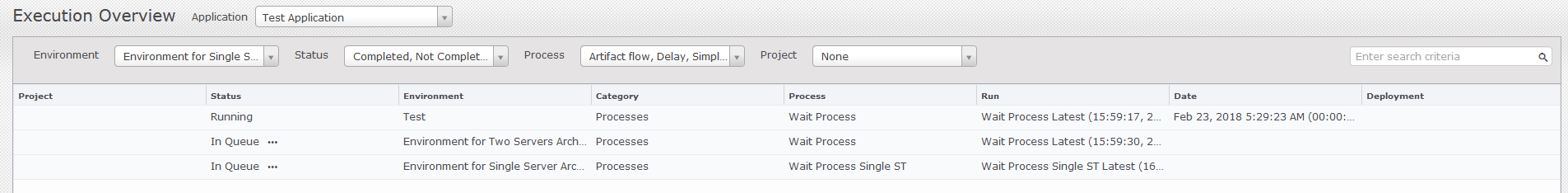

      1. Login to ROC and navigate to Environments-> Execution overview
      2. Filter the process run, make sure to uncheck all project option making it as "None". An example process list will be shown
      3. Navigate to the process which is "In Queue", identify server participating in that run and stop/remove running process which are halted or running on those agents for long time.
