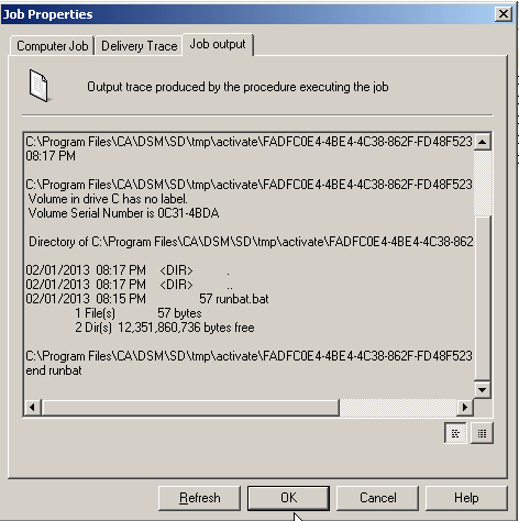

7. Add the '>$rf' parameter so that the job output can be captured and displayed in the DSM Explorer. Click OK.
8. Right-click and chose 'Seal' to seal the package to be able to deploy it.
9. Deploy the package to the desired machine to test and troubleshoot deployment issues. If the job is successful, the output will be displayed in the Job properties under the 'Job Output' tab.
