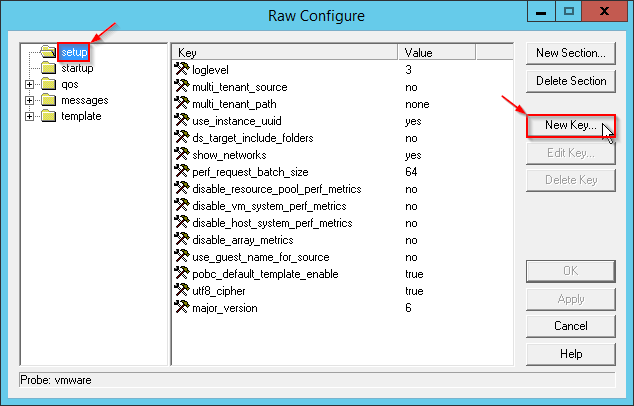

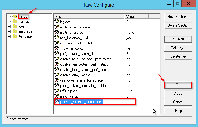

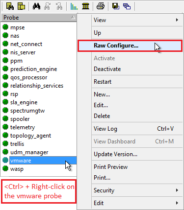

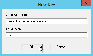

2. Using Raw Configure, add the following to the <setup> section of the vmware probe config:
prevent_vcenter_correlation = true
