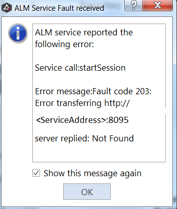

When using the GT HP ALM Service Connector in Agile Requirements Designer, I am receiving the following error message:
ALM Service Fault received.
ALM service reported the following error: Service call:startSession. Error message:Fault code 203:
Error transferring http://<ServiceAddress>:8095- server replied: Not Found

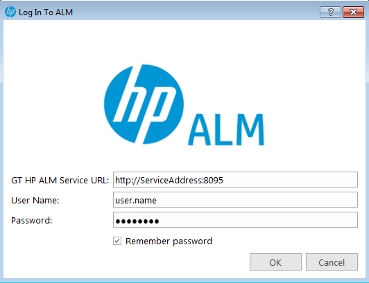

4. In the Connectors Dock, click on the Login button.
5. Login to ALM using the Service Address URL. Hit the OK button.

The Service Address being used in Agile Designer when logging into ALM is incorrect.
Assuming the service base address is set to 'http://*:8095/' or 'http://ServerName:8095/' (either is valid) in the ALM Service Config Editor, the address we should use in Agile Designer should be 'http://ServerName:8095/ALMService'.

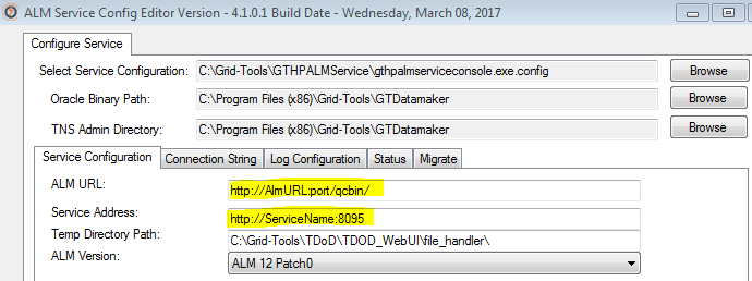

Now that you know the correct Service Address to use in ARD, follow the steps below to finish setting up the GT HP ALM Service configuration and login process:

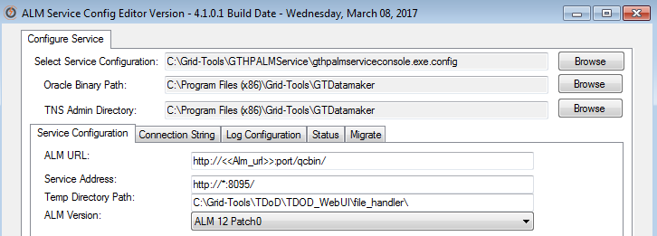

  1. Go to the ALM Service Configuration Editor. By default, this is located at C:\Grid-Tools\GTHPALMService\GTHPALMService_ConfigEditor\ALMServiceConfigEditor.exe when you install TDM.
  2. In the 'Service Configuration' tab, you need to verify you are using the correct 'ALM URL' format and the correct 'Service Address' URL.
    • ALM URL: 'http://AlmURL:port/qcbin/'
    • Service Address: 'http://ServiceName:8095/'
  3. Click the 'Save' button to save your changes.

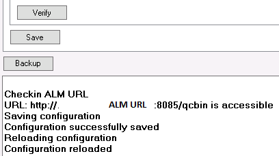

  4. Click the 'Verify' button and check the message box for any error messages. The ALM URL should be accessible.

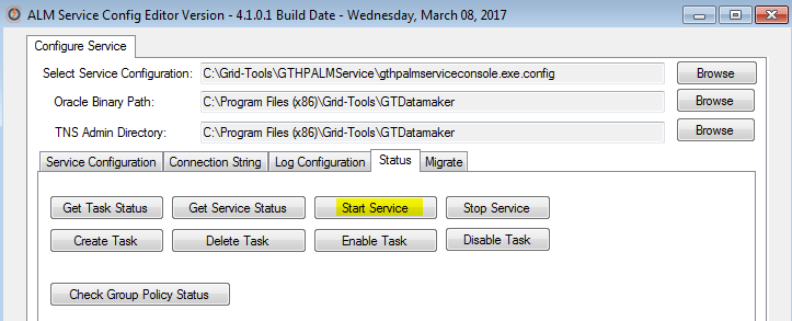

  5. In the same window, click on the 'Status' tab.
  6. You may need to create a task and enable group policy at this point if you have not previously configured this.
  7. Click the 'Start Service' button. If already running, stop the service first, then restart it.
    • If you get errors pertaining to the task not existing or group policy not being enabled, please see our documentation on configuring this: Install HPE ALM Service
  8. Check the message box for any errors. The GT ALM Service should be running.

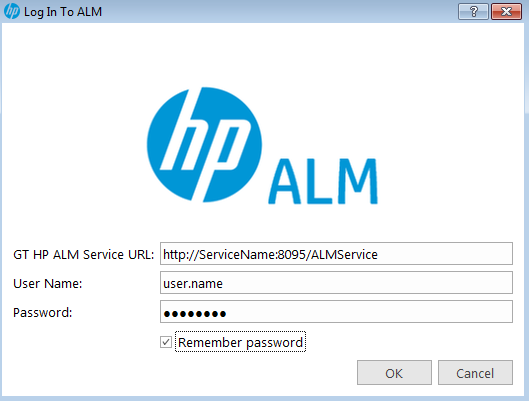

  12. Under the 'Connectors Dock' on the right-hand side on the screen, you will see a message of 'This view is disabled - please login to ALM'. Click the 'Login' button.
  13. In the 'Log In To ALM' window, enter the following information, and click the 'OK' button once done.
    • GT HP ALM Service URL: 'http://ServiceName:8095/ALMService' (You will have the /ALMService in this URL, but not in the Configuration Editor)
