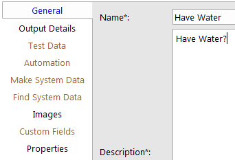

Option #1
- When creating new test cases, do not add any special characters in the 'Name' field, but instead, add them in the 'Description' field.
- For example:
Description: Have Water?
