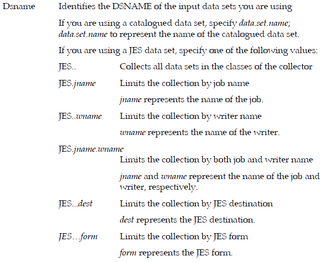

The following excerpt from the Bundl documentation outlines OTHER possible fields that could have been coded in the INPUT Dsname field that may have been specified INCORRECTLY and that would cause the "BND7903E GETDSN SSOB failure RC=1C" message to be received:
