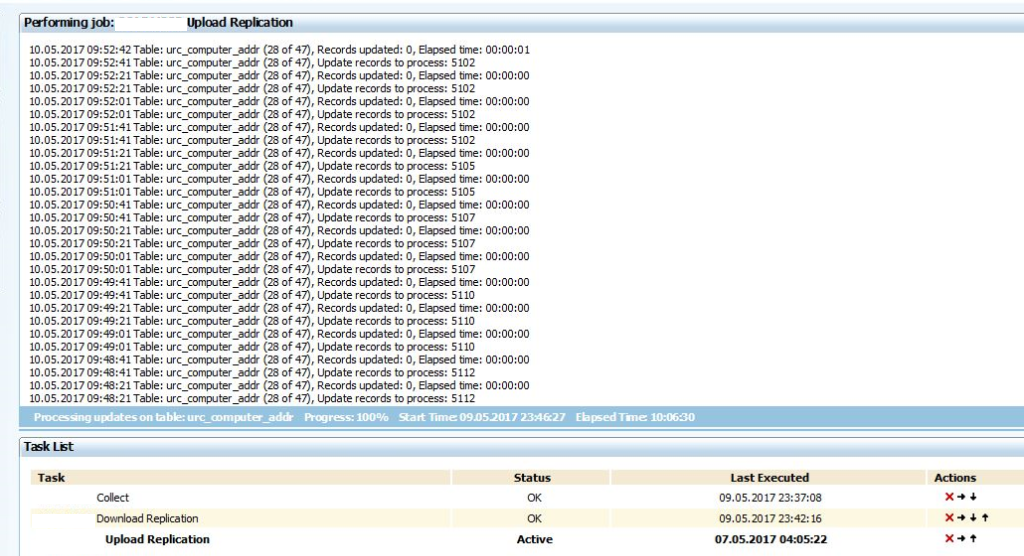

On Domain Manager, system engine upload replication task showing problem with urc_computer_addr. As shown in below screenshot.
Checking SystemEngine log shows below error:
|ERROR  | Exec command pointer failed
|ERROR  | GetActionOnError: MS SQL dbErrCat=-3, dbDetailedError=-7, errorInfo=ADO Version 6.1 - ExecuteCommandPointer  -COM Error: ErrorCode:-2147217900,WordErrorCode:3092, IDispatch error #3092, Maximum stored procedure, function, trigger, or view nesting level exceeded (limit 32)., Microsoft SQL Server Native Client 10.0, (null)
|ERROR  | SetIntermediateStatus1: Upload: Connection to Enterprise Database lost - Job aborted
|ERROR  | DoTableUpdate - Failed to Update rc=[-3] sql=[update urc_computer_addr set domain_uuid=?,computer_uuid=?,protocol=1,flags=0,strAddress=? where  uuid=0x116C233FBE5AB64D8B8F0A4C0F4473C9]
|ERROR  | SetIntermediateStatus1: Upload: Replication failed during updating stage
|NOTIFY | urc_computer_addr 0 records select 0 sec - update/insert 0 sec - createobjectmap 0 sec - usedbybatch 0 sec - usedbyexist 0 sec - usedbyCORA  0 sec
|ERROR  | DoTableUpdate - Chunk processed failed - tablename=urc_computer_addr, count=1, inserted=0, failed=1
|ERROR  | SetIntermediateStatus1: Upload: A database error was encountered
|ERROR  | Fewer records were updated than expected for table: urc_computer_addr. Expected to update: 6407, actually updated: 0
|ERROR  | cReplicationJob::Run() - DB reconnected: retry [326]
