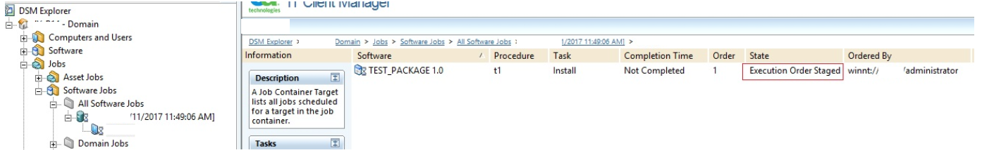

The SD Jobs are executed on target machines but they remain in status "Execution Order Staged" in ITCM GUI.
If command "sd_sscmd bulkupdate" is manually executed on the Scalability Server, the SD Status are reported to the DOMAIN.
Why SD Status are not reported automatically and need a manual execution of bulk update ?

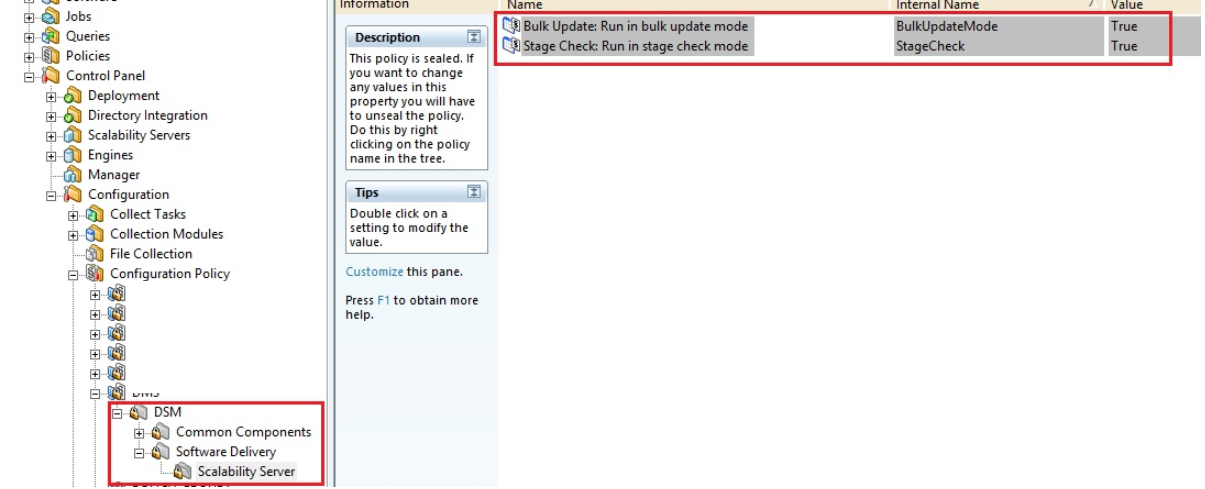

This problem could occur if "Bulk Update Mode" and "Stage Check Mode" are both enabled in the configuration policy applied on the Scalability Server under DSM/Software Delivery/Scalability Server :
When Stage Check and Bulk Update modes are enabled at the same time, the stage check interval takes precedence over the bulk update interval as described in the product online Help :
How SS Handles Messages—Bulk Update Enabled, Stage Check Enabled
When you configure the scalability server to run in both the modes, the stage check interval takes precedence over the bulk update interval, but the messages are sent in bulk. For example, if you configure the scalability server to perform stage check after every 60 minutes and bulk update after every 10 minutes, the scalability server sends the messages to the Installation Manager in bulk after every 60 minutes. The scalability server ignores the bulk update interval.

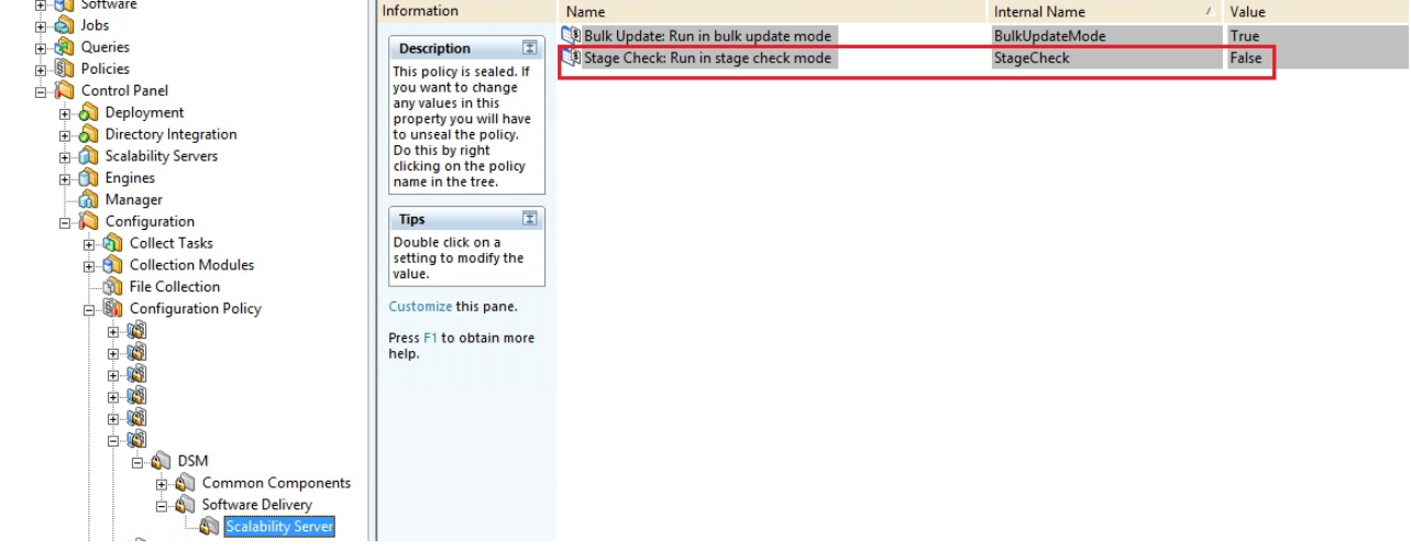

The solution in order to have "bulk update" task executed is to disable stage check mode in the configuration policy applied on the Scalability server
DSM/Software Delivery/Scalability Server/Stage Check: Run in stage check mode = False
