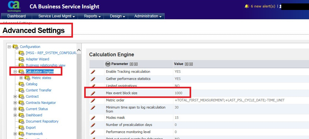

The simplest resolution to this problem in the event that the PSLwriter ran out of RAM is to reduce the max event block size in the advanced settings. This determines how many events the PSLwriter will try to save to RAM at one time:
For example, reduce this to 500 or in some rare cases even lower; the lower limit is 1. Note that lowering this value may reduce performance, as it then requires the PSL Writer engine to load and unload events from the database more frequently. It does, however, cause the engine to use less RAM. The aim is to ensure that the PSL Writer is not going much above around 1GB of memory usage, which you can see in the Task Manager. If you are using a lot less, you can increase the event block size and process a greater number of days per cycle for better performance.
