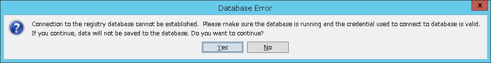

When using DevTest Workstation for a while, the error dialog below may appear.
If selecting the "Yes" button, then
And if selecting the "No" button, then DevTest Workstation is closed.
This dialog appears after logging in to the registry from the DevTest Workstation.

If you want to use DevTest Workstation without any restrictions then
When selecting the "Yes" button in Database Error dialog, the staging test restriction is described as below:
| Note: There are two choices for the coordinator: "Coordinator@default" and blank. If you select blank, then the simulation starts on the workstation machine and it will need connectivity to the DevTest database. |
in the documentation section "Stage a Test Case"
And the test suite is explained as below:
| Running a test suite requires connectivity to the DevTest database. |
in the documentation Section "Run a Test Suite
Additionally, ITR Utility is explained in the documentation section "Interactive Test Run (ITR) Utility"
NOTE: This property was introduce in DevTest 10.8.0 and can be uncommented in the Registry site.properties file if the Workstation is not to be connected to the Registry database. Registry will have to be restarted to pick up the value.
## Should the Registry Database in the Workstation be connected?
##lisadb.workstation.enabled=false
