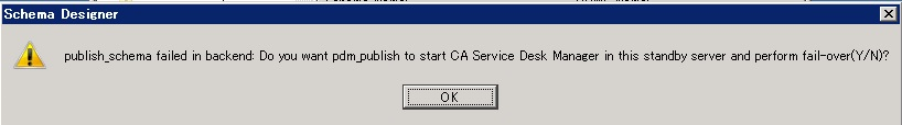

After manually adding custom columns, for example, loading the wspcol table to a server, when selected "save and publish" in Schema Designer, an error "publish_schema failed in backend: Timeout waiting for reply after 60 seconds" comes up as shown below and the schema changes cannot be saved.
If we click on the "save and publish" again, the following error appears and the changes will not be saved.
