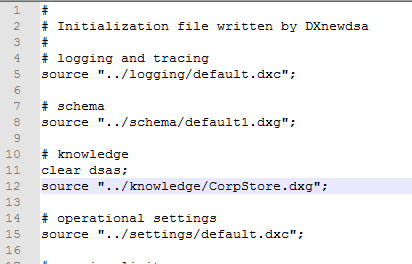

5) Go to the following location (C:\Program Files\CA\Directory\dxserver\config\servers) Open each dxi file for the data DSA’s and the router DSA and modify the # Knowledge section to source the .dxg file we created in step 6. See image below.
