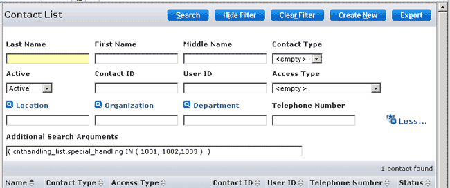

When you've associated some users with Special Handling and you want to list only those specific contacts in a Contact List, you can achieve this by adding a certain specification to the Additional Search Arguments field in the Filter before clicking on Search.

  2. Based on the above example, add the following string to the Additional Search Arguments field:
    ( cnthandling_list.special_handling IN ( 1001, 1002,1003, 1004 ) )
