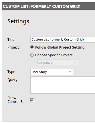

Steps below assume that we already added a Custom List to your page and we are ready to specify the settings.
1. Set Type to User Story and click Save to close Settings dialog.

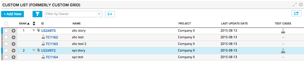

3. The List loads. Expand user stories to see test cases:
TestCases attribute can also be added via the Column picker:
