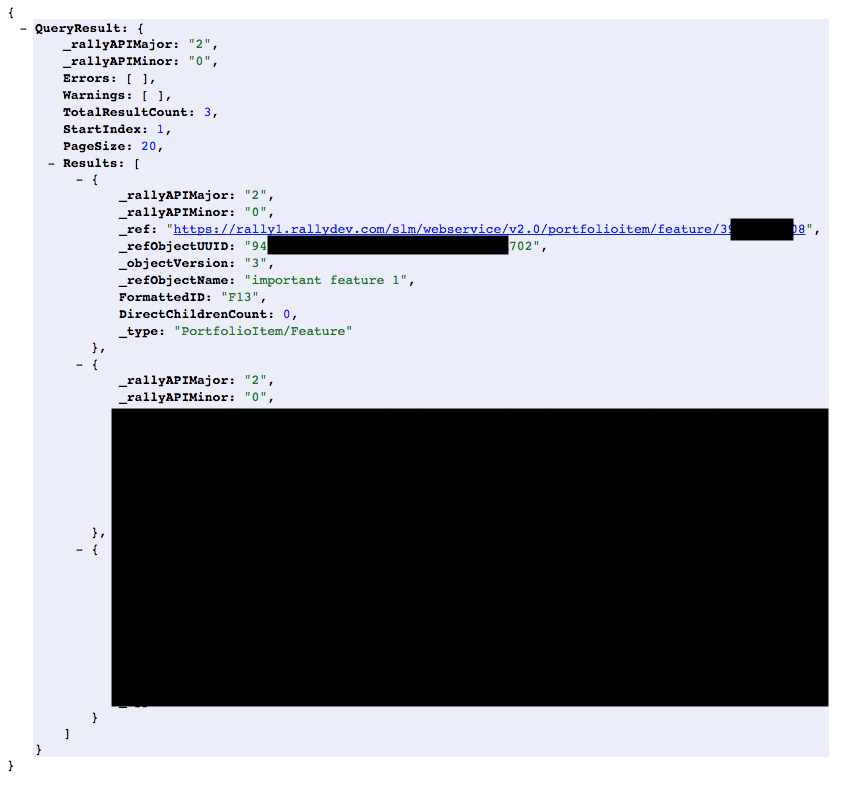

Troubleshooting tips:
Test your query directly in WS API and in the browser before using it with Google Apps Script.
For example, here is a direct endpoint that returns children of PortfolioItem/Initiative:
https://rally1.rallydev.com/slm/webservice/v2.0/portfolioitem/initiative/<INITIATIVE_OID/children?workspace=https://rally1.rallydev.com/slm/webservice/v2.0/workspace/<WORKSPACE_OID>&fetch=FormattedID
Here is the equivalent query in Google Apps Script
