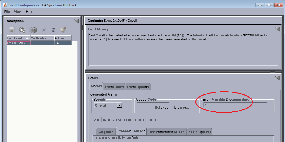

The 0x00010d05 event id is the event associated with the "UNRESOLVED FAULT DETECTED" alarm. By default, this event has Event Variable 2 set as an Event Discriminator. See screen shot below:
For this issue, the 0x00010d05 event had been modified and the Event Discriminator configured on Event Variable 2 had been removed.
Remove the change to the 0x00010d05 event so Event Variable 2 set as an Event Discriminator again and then update the Event Configuration.
NOTE: The 0x00010d05 event is an out of the box event used by Spectrum's Fault Isolation, Fault Suppression and Impact Analysis functionality. Modifications to any of these type of events may cause undesirable results.
