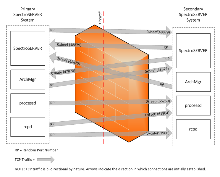

Communication is blocked between the Primary and Secondary SpectroSERVERs. This is typically caused by:
  • A network firewall blocking the required ports.
  • The OS-level firewall (such as firewalld or iptables on Linux) being enabled or reset to default rules.
  • The processd service being stopped on the Secondary SpectroSERVER.

  3. Ensure Port Availability: Verify the following ports are open bi-directionally between the Primary and Secondary systems:
    • 65259 (processd)
    • 61904 (processd)
    • 51966 (rcpd)

Verify connectivity from primary to secondary SS on these ports below:
  • 65259 (0xfeeb) (processd)
    (on the primary SS run) nc -zv <secondary SS> 65259
  • 61904 (0xf1d0) (processd)
    (on the primary SS run) nc -zv <secondary SS> 61904
  • 51966 (0xcafe) (rcpd)
    cd $SPECROOT/SS/
    ../SS-Tools/rcpd -recv -f .ft_save_file.SSdb
    rcpd will run for 3 minutes and it will end automatically. So run the next command while the rcpd is running on the secondary SS.
    (on the primary SS run) nc -zv <secondary SS> 51966
Please reference the "Communication Across Firewalls" section of the documentation for more information:
