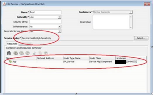

The Service Hierarchy is created when one Service is a Resource for another Service. Using your example, I created three different Services:
Prod
App
Host
For the Prod Service, I made App a resource. For the App Service, I made Host as a resource. See example below:
After making one Service the Resource of another, the Hierarchy is automatically built. See below:
This can be done from the command line using the Command Line Interface by associating one Service to another using the “SlmMonitors” relationship. The model handle on the left of the association will be the Service higher in the Service Hierarchy. The following is an example of the association between the “Prod” Service and the “App” Service:
