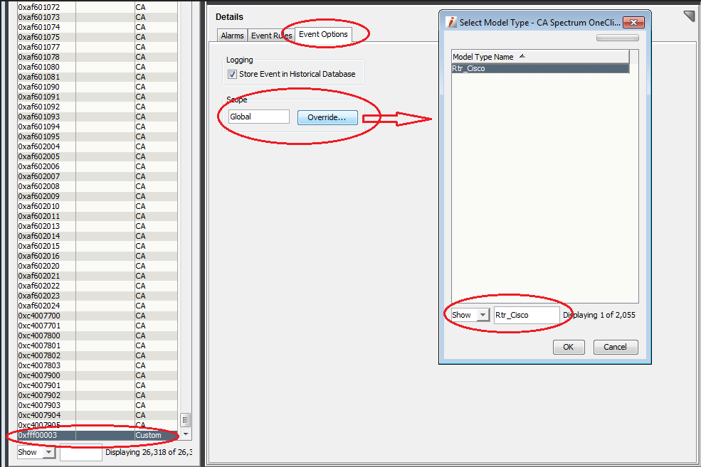

4. In the Navigation panel, select the event you just created:
    a. Click on the Event Options tab
    b. Click on the Override button to the right of the Scope field
    c. Filter for and select Rtr_Cisco from the list and click the OK button
    d. You should now see two instances of the same event in the Navigation panel. The first one created that generates only an event a new one:
5. Select the new event and finish configuring it to assert the alarm. Then, click on the "Saves changes to selected events" icon or select either File -> Save All or Save Selected from the top level menu.
