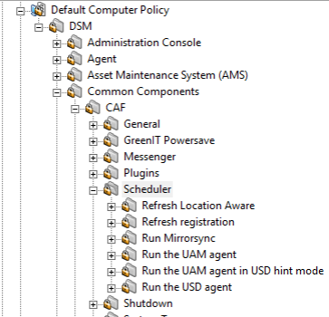

In the Configuration Policy there are 6 tasks under DSM/Common Components/CAF/Scheduler :
Refresh Location Aware
Refresh registration
Run Mirrorsync
Run the UAM agent
Run the UAM agent in USD hint mode
Run the USD agent
These tasks are available on the machines by checking the properties of the Common Agent from caf systray icon:
How to create another task ?
