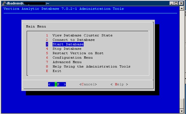

1. Logon as the dbadmin user and launch the adminTools utility:
    $ su - dbadmin
2. This will bring up the menu below. Select (1) to check the database status, if it is down, check the option (3) to start it:

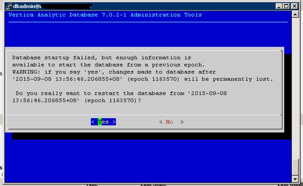

4. Use kill command to terminate all processes listed by the above command and then follow the procedures from 1 to 3 again and you should be prompted to the screen similar to the one below. Click Yes to confirm database restoration from the last known epoch:
5. If successful, the vertica database will be up and you will be brought back to the menu where you can select (E) to exit the menu and return to the Linux prompt.
