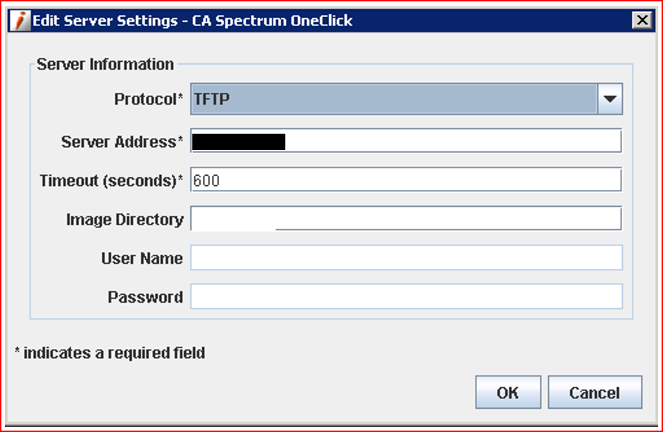

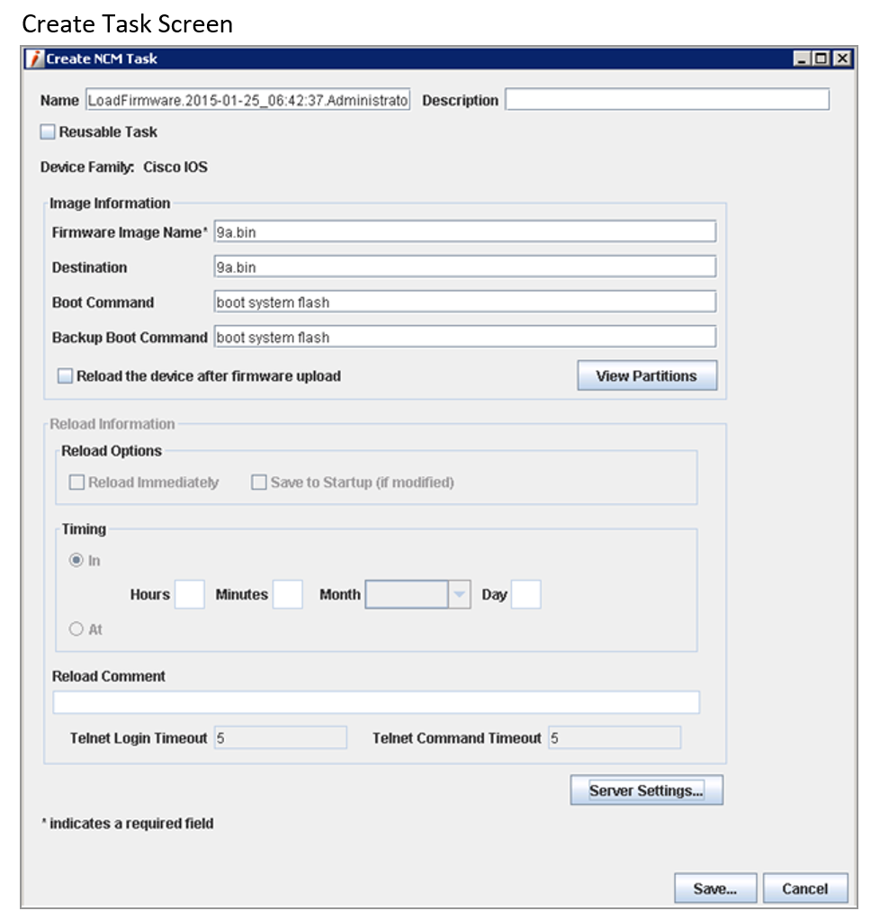

If the Device Firmware Transfer Settings are configured with image directory then you should not give Image directory under Server Settings.
It will append both values and always gives the Error  "Invalid Server Address" even though the configured settings are correct.
