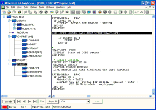

We could, at this point, go into a long discussion about using the visual debugging capability on Windows but describing it in words just doesn't seem to work. Functionality like setting a "watch" on a field and auto-stepping through a program to view the value change for that field is probably better seen than written. We will say that, when working with client issues, the first step we take is to bring their source into Windows. Once we compile the program, we view it in "analyze" mode to get a simple picture of how it works. This looks something like this:
At this point, we can start to examine the program flow and look for the point of failure. In some cases, we have to mock-up a row of input data which, for testing purposes, is pretty easy to do as long as we have the file definitions. Now, we can debug and step through the program. If we want to follow a certain flow within the program, we simply change the appropriate value within the Data Director to ensure an IF or CASE path is taken. This allows us to quickly find what is causing the issue. Used internally within our Support groups, the Windows version allows us to quickly narrow down whether an issue is a programming problem or a product problem.

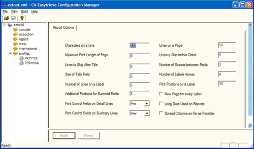

The last feature that we want to expose in this article (and once again, its functionality could be a whole topic by itself), is the Configuration Manager. In simple terms, this allows you to visually explore and change the Easytrieve Options Table that controls the product functionality. A snapshot looks like this:
Worth mentioning is that the Configuration Manager allows you to generate an Options Table that can be targeted for any platform that Easytrieve supports. So, we can make changes and then select the "Build" menu and generate a file for z/OS (or UNIX). Once generated, we simply FTP that file to a dataset on z/OS and point our JCL to use it. This same GUI also manages Printer Set Definitions (PSD files) which can be used to control output generation through the extended printer support that is built into Easytrieve. PSD files can be used to generate HTML output or to control the fonts and layout used within reports that get sent directly to printers... but that is a topic for a different time.
