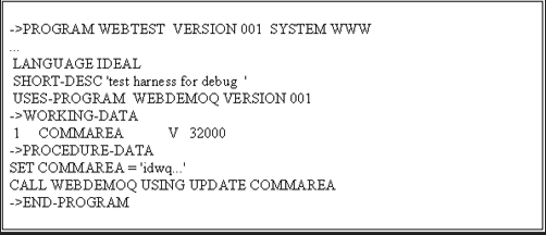

This method is appropriate only for applications that are invoked via GET and do not need an expanded (>32KB) response.
A simple top-level program is created to invoke the Web subprogram from a 3270 session, so that it can be treated by the debugger as a "regular" application. Starting a debug session on this program then provides the environment for setting breakpoints in the subprogram. An example is given below:
You can use this method prior to adding an entry to the SCWBTRAN table, as the Web driver is not involved. Most of the early demonstration samples were developed using this method.
