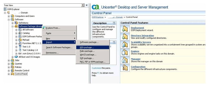

  • Right-click on the Software Library and select Import->MSI-package.

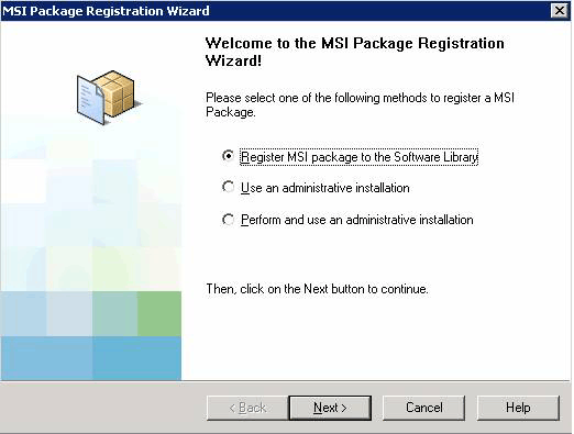

  • Select the option 'Register MSI to the Software Library' and Click Next.

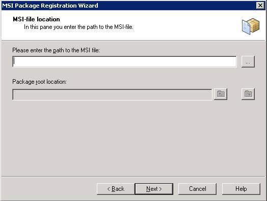

  • Specify the location of the MSI file and proceed further.

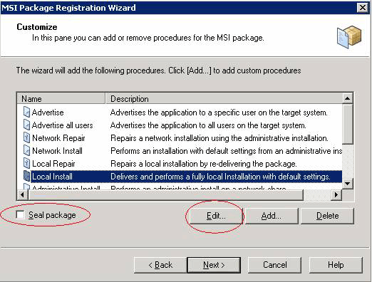

  • In the 'Customize' window uncheck the 'Seal Package' option. Select the Local Install procedure and click on 'Edit'.

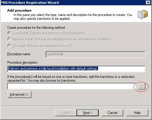

  • Specify the location of the MST file and proceed further and make the MSI configuration changes as needed.

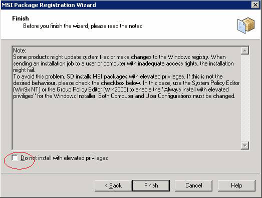

  • In the Finish screen make sure that the option "Do not install with elevated privileges" is unchecked and click Finish.
