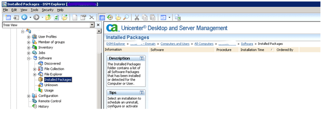

One of the agents got deleted accidently from the DSM Explorer.
It was re-registered again by running a USD job check on the agent. The machine re-appeared under 'All Computers' but the installation records are missing.
<Please see attached file for image>
Figure 1
I know the packages that were installed on the agent. Is there a way to add the install records manually?
