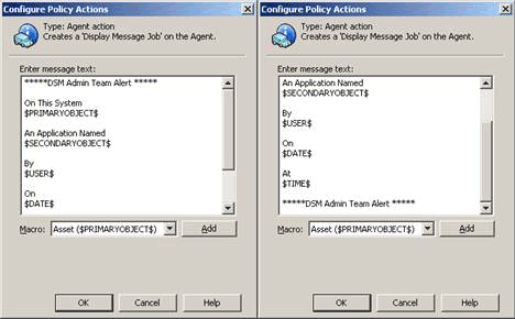

    1. Select the type of action that you want to perform if this even occurs.
      (For e.g. a message will be displayed on the agent system or an email with Details will be sent to multiple recipients etc.)
    2. Setting up email notification
    3. Setting up message notification (the message may have whatever information is required, this is just an example):
