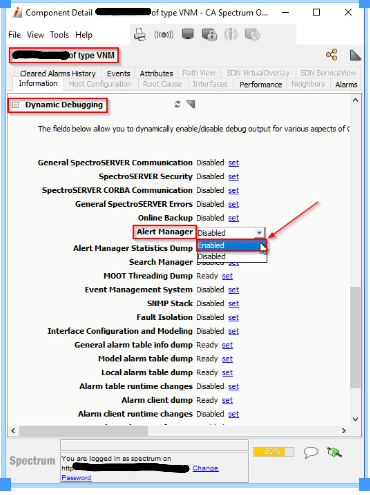

1. The simplest method to enable Alert Manager debug is to access Dynamic Debugging options on VNM model:

For either method, any time a trap is then received and processed some output will be written to the server console (VNM.OUT). It will contain some details about how that trap was handled, which models it was sent to, which event was generated, etc.
If debug shows up for the traps, then you can be sure the trap is being received. The debug output can be further evaluated to determine the trap's fate.
If there is no debug output, either it did not even reach the server or there was a failure in the layers before the alert manager. It is recommended to run a sniffer / packet capture to confirm the trap is landing on the server.
