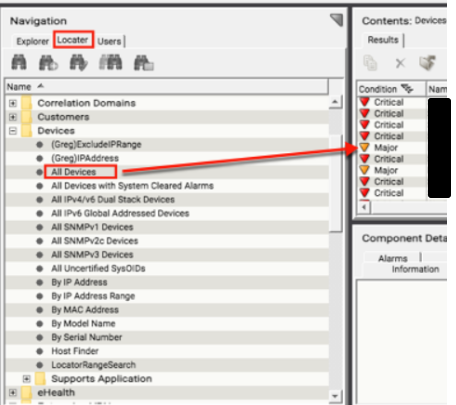

1. Log into OneClick as an ADMIN user
2. From the Locator Tab, select Devices->All Devices

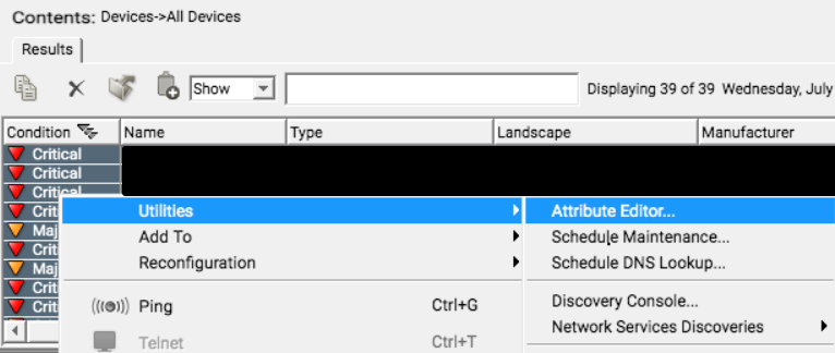

3. Select all the device models listed in the results window.
4. Right click to bring up the menu on the result set and select Utilities->Attribute Editor
