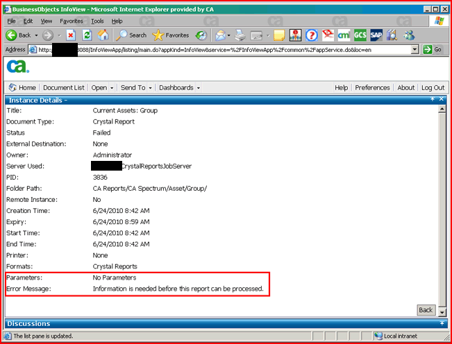

Evidence of the failed scheduled report:

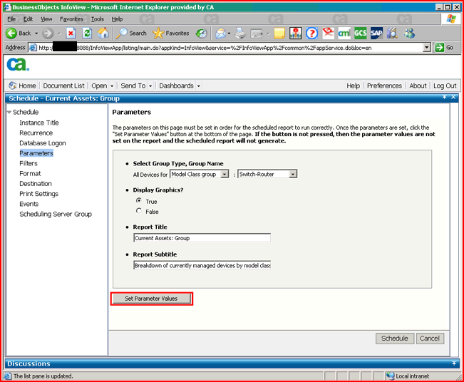

Even if all the parameter values are specified on Schedule page, you must click the [Set Parameter Value] button to save the parameter values.
