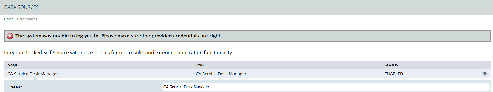

The following error appears when testing the connection from Unified Self-Service to Service Desk Manager datasource:
The system was unable to log you in. Please make sure the provided credentials are right.

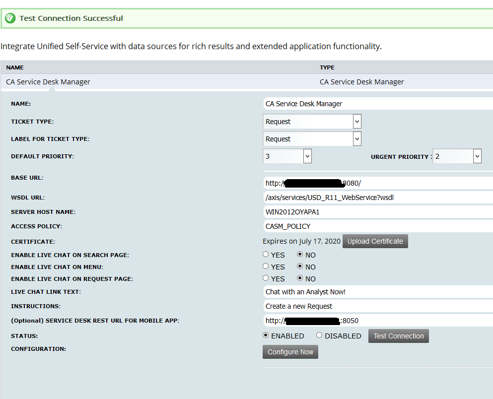

Example of a successful connection:
