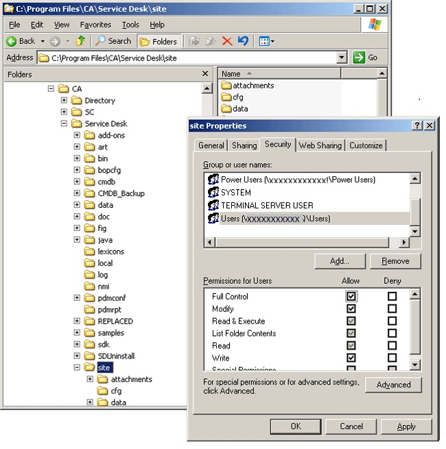

The error is generated when the user is not a local administrator, and does not have "Full Control" permissions on the "Service Desk\site" folder
To ensure the user has the correct permissions, follow these steps:
Right-click on the "Service Desk\site" folder.
Select "Properties".
Click on the "Security" tab.
Click on "Users"
Click in the "Allow" checkbox next to the "Full Control" permission. See Figure 1.
You should now be able to run the pdm_publish command successfully.
