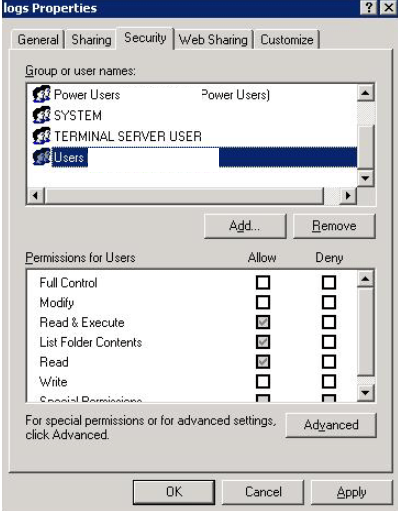

By default the NTFS security rights on C:\Program Files\CA\DSM\Web Console\logs allows only Read access to the group "Users".
The user "Network Service" belongs to group "Authenticated Users" which belongs to the group Users.
As w3wp.exe is started with "Network Service", it has no write rights on the directory C:\Program Files\CA\DSM\Web Console\logs.
Therefore, the file C:\Program Files\CA\DSM\Web Console\logs\isapi_redirect.log is not created.
  • Add NTFS Modify rights on group "Users" for directory "C:\Program Files\CA\DSM\Web Console\logs" Or add the user "NETWORK SERVICE" with NTFS Modify rights on the directory "C:\Program Files\CA\DSM\Web Console\logs".
