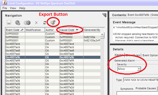

The Event Configuration editor can be used to see how all of the above files are tied together.
After launching the Event Configuration editor, right mouse click on any of the column headers in the Navigation tab and display only the Event Code, Cause Code and Event Message columns.
Then, sort on the Cause Code column. Any entry in the list that has the Cause Code column populated is an event that generates an alarm.
You can click on the Export icon (the one that looks like a file folder) and export the information to a csv file format that you can then open in Excel.
The following is an example:
