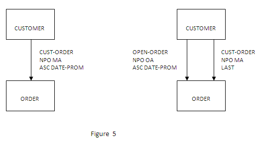

The processing of long set relationships will frequently be the cause of inflated numbers for both the RECORDS-CURRENT and RECORDS-REQUESTED statistics. When only a subset of the member records of a set relationship are needed it may be helpful to add an additional set relationship between the two record types to reduce the number of records that must accessed by higher priority transactions. Figure 5 shows the addition of an OPEN-ORDER set between the CUSTOMER and ORDER records to reduce the number of records that must be accessed by those transactions only interested in orders that have not yet been filled for a particular customer. This should reduce both the RECORDS-CURRENT and RECORDS-REQUESTED counts for those transactions.
Long sorted chain sets can often result in large numbers of RECORDS-REQUESTED while the value of RECORDS-CURRENT is relatively small when random reads are made against the set using the set's sort key. With a sorted chain set CA IDMS must walk on average half the set's members to locate the desired record. Each record checked results in the RECORDS-REQUESTED field being incremented to reflect the amount of work performed by the DBMS. If the bulk of the DML requests will be expected to be satisfied by records at the end of the set consider reversing the sequence of the set so that the desired records will be found at the set's beginning. However if the records are expected to be found throughout the set, consider changing the set from a chain set to a user-owned index set. Though this means that you must always access an index structure to locate the desired record occurrence this can frequently result in fewer RECORDS-REQUESTED than having to walk each data record preceding the desired occurrence.
Finally a high RECORDS-REQUESTED value can result from the lack of proper PRIOR or OWNER pointers on a set relationship. Missing PRIOR pointers can result in extra record occurrences being accessed for DISCONNECT and ERASE verbs or MODIFY verbs where the sort key of a set is being changed. Execution of FIND/OBTAIN OWNER verbs can also cause extra record occurrences to be access if the set involved has not been defined with OWNER pointers. If any of these verbs are used by the program being analyzed the missing pointer types should be added to the involved sets.
