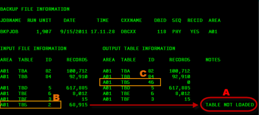

Here is an example report showing this error situation:
In this case, Table TBS was not loaded (Box A), although the input file shows there were 68,915 records. Looking at the description of these tables further, Table TBS was defined with Datacom ID 2 in the source system (Input Box B), but it was defined with Datacom ID 46 in the target system (Output Box C). As noted in the Datacom/DB DBUTLTY documentation for the LOAD command:
