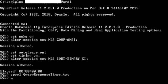

sqlplus user/password@ServiceName
Figure 1
set echo on
alter session set NLS_COMP=ANSI;
set autotrace on;
set timing on;
If you have Service Desk configured for case insensitivity (@NX_ORACLE_CASE_INSENSITIVE=1 within the Service Desk NX.env file), set:
alter session set NLS_SORT=BINARY_CI;
Create an output file so that the results can be provided to your DBA or CA Support:
spool QueryResponseTimes.txt
Figure 2
Figure 3
Review the output with the help of your DBA or provide it to CA Support as directed. Please note the output file will be empty until you turn off spool or exit SQLPLUS
