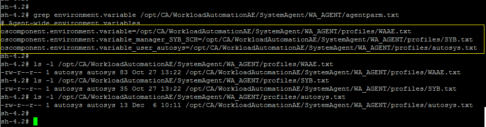

On the CA WA System Agent host, check the following parameters' values in the agentparm.txt file under the System Agent installation path and ensure that the files, assigned to each of these parameters, do exist.
oscomponent.environment.variable
oscomponent.environment.variable_manager_manager_id
and
oscomponent.environment.variable_user_user_id
Example from a Linux CA WA System Agent installation:
If any of the files are missing, then either comment the corresponding parameter out in the agentparm.txt file and restart the WA System Agent service, or copy the missing environment file from another working CA WA System Agent host.
