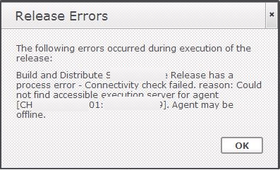

Connectivity check failed. Reason: Could not find accessible execution server for agent. Agent may be offline.
Article ID: 48110
CA Release Automation - Release Operations Center (Nolio) CA Release Automation - DataManagement Server (Nolio)
Agent connectivity check fails with the error 'Connectivity Check failed. reason: Could not find accessible execution server for agent'.

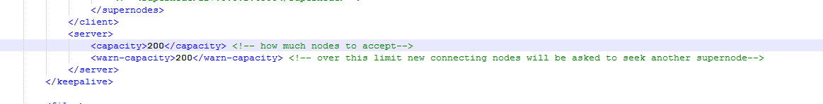

The current default definition of the number of agents can be found in <RA_EXECUTION_SERVER_INSTALL_DIR>/conf/nimi_config.xml
  <server>
  <capacity>200</capacity> <!-- how much nodes to accept-->
  <warn-capacity>200</warn-capacity> <!-- over this limit new connecting nodes will be asked to seek another supernode-->
 </server>
1. Increase the number of agents that can be handled by an Execution Server, by modifying nimi_config.xml.
Example for increasing the capacity to 250.
  <server>
  <capacity>250</capacity> <!-- how much nodes to accept-->
<warn-capacity>250</warn-capacity> <!-- over this limit new connecting nodes will be asked to seek another supernode-->
</server>
