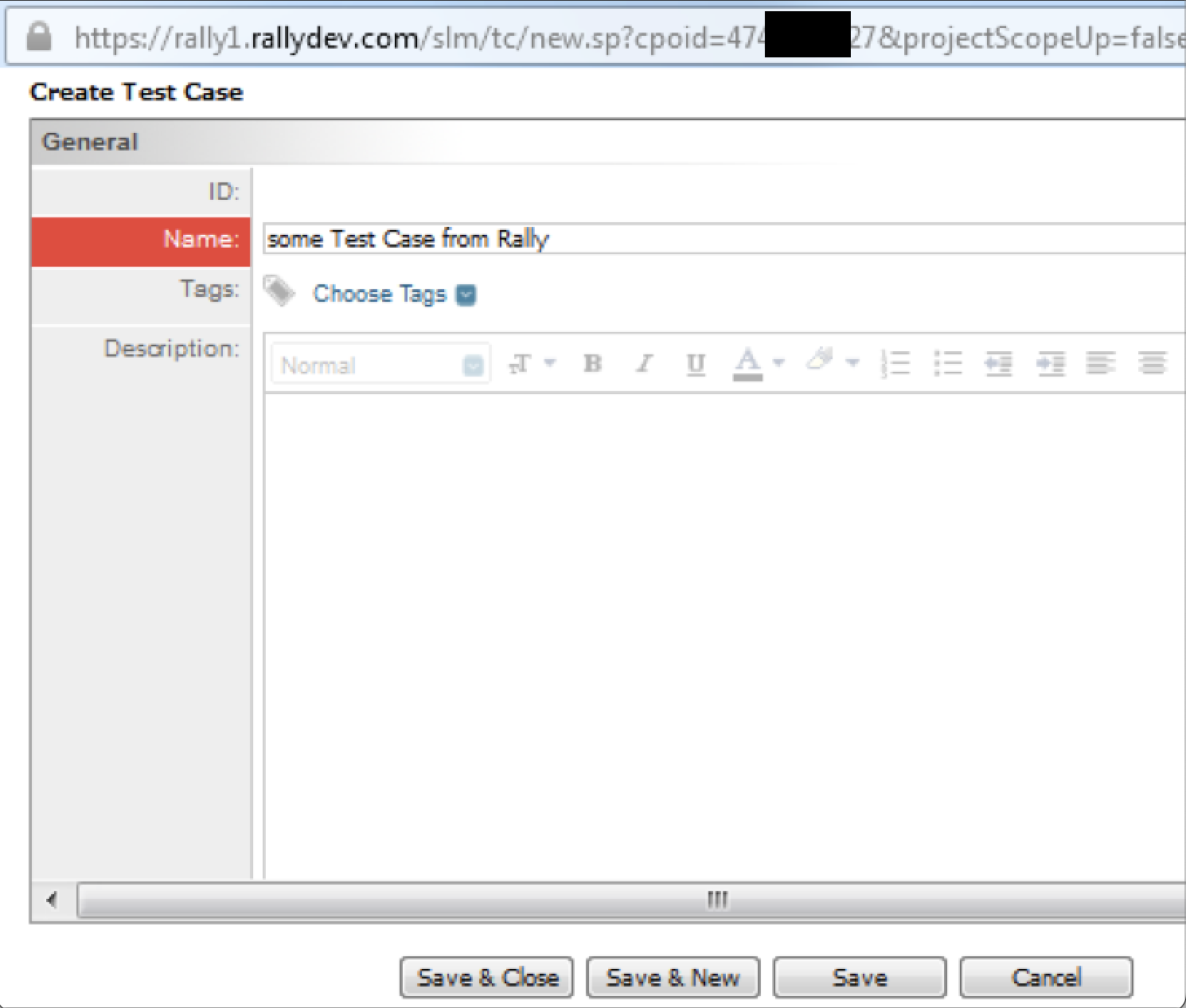

1. Create a test case in Rally:

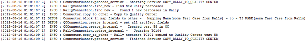

3. Run the connector:

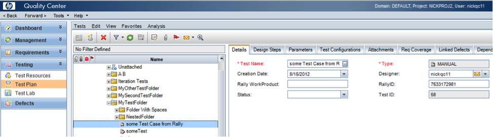

The test is created in QC. Notice the TS_USER_01 labeled ?RallyID? field populated with Object ID of the corresponding CA Agile Central test case:

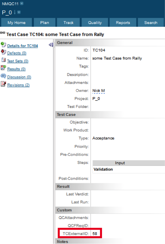

On the Rally side the original test case now has its custom field TCExternalID populated with the ID of the corresponding QC test:
