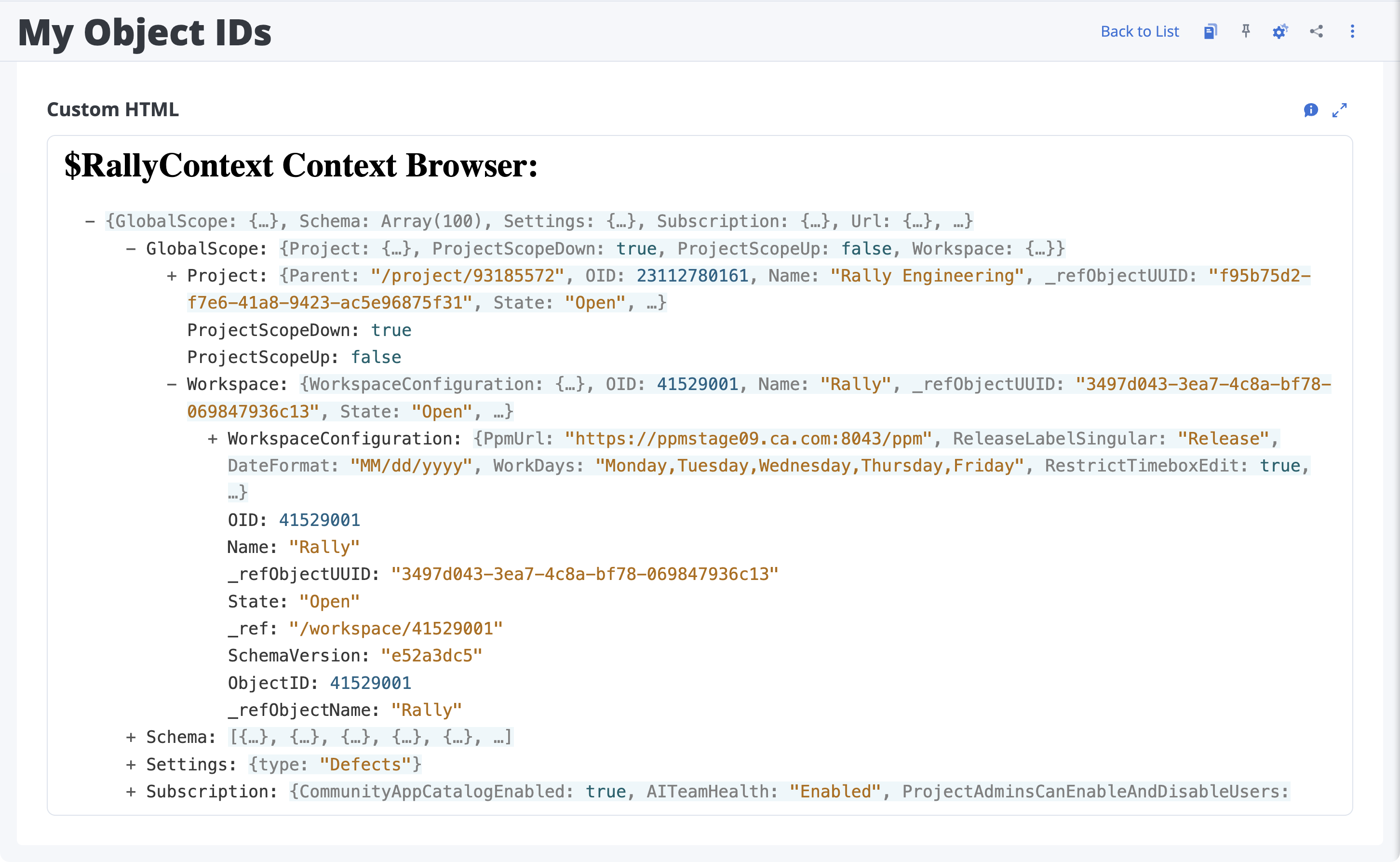

1. Create a new Custom View. The advantage of using a custom view like this is that you can always refer to it later as long as you do not delete this Custom View.
<head> <script src="//unpkg.com/json-viewer-custom-element"></script> <script> // $RallyContext:Begin const $RallyContext = { WidgetName: 'My Widget' } // $RallyContext:End window.onload = () => { document.getElementById('json-viewer').setAttribute('value', JSON.stringify($RallyContext)); } </script> </head> <body> <h1>$RallyContext Context Browser:</h1> <json-viewer id='json-viewer' value="{}"></json-viewer> </body>
The Global Scope item contains information about the currently selected scope.
2. Get the ObjectID of a current workspace using the Web Services API
