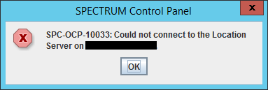

The following error is displayed when launching the SPECTRUM Control Panel:
SPC-OCP-10033: Could not connect to the Location Server on XXXXXX (SpectroSERVER hostname)

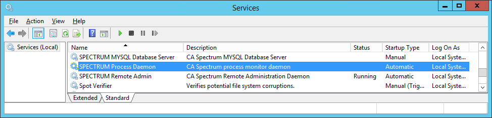

One possible root cause is because the CA Spectrum Process Daemon service is stopped.

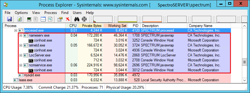

Another possible root cause is because either the Location Server (LOCSERV) or Naming Service (NAMINGSERVICE) processes are stopped.

Start the CA Spectrum process Daemon service.
Start Location Server or Naming Service in case they are stopped.
