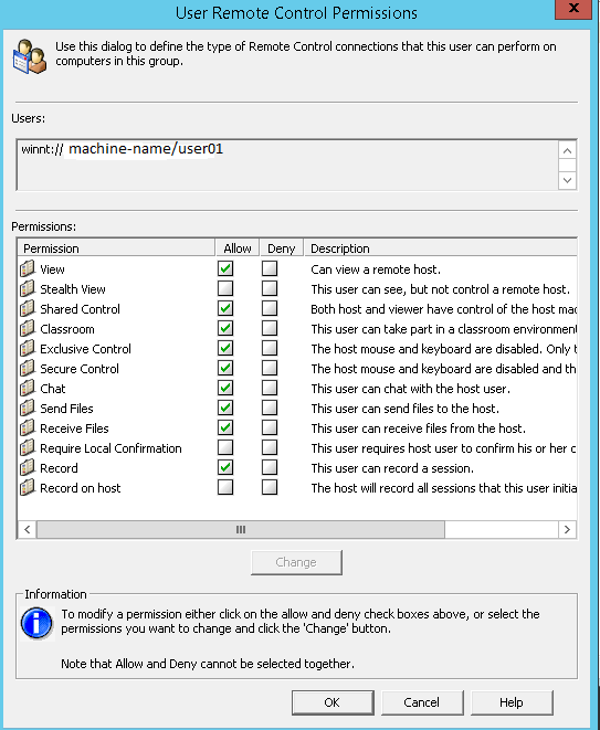

From DSM Explorer you can modify permission on the allow and deny or select permission for Remote Control Users
The remote control permission modify are traced under Domain Manger log file TRC_URC_MANSRV_x.log
