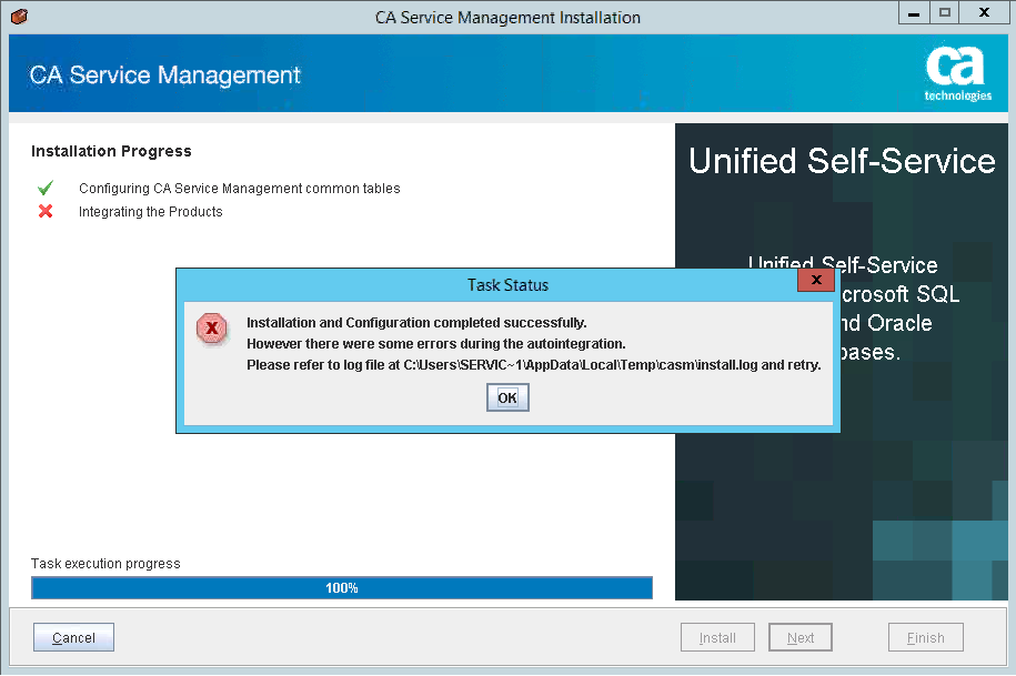

When installing or upgrading Service Management with a custom instance of SQL you may receive the message below during the Integrating the Products step.
"Installation and Configuration completed successfully. However there were some errors during the autointegration."
